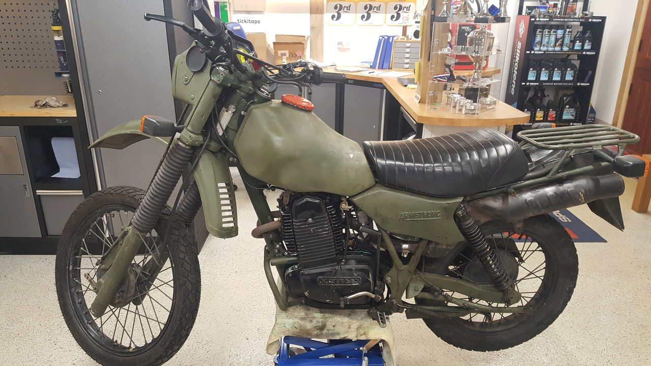

We had a working weekend at Sportax to keep on top of things. Decided to do this unmolested MT500 which needed a new head and base gasket, new piston rings, new oil seals and gaskets throughout, new MK3 clutch, decoked head and valve lap, new Dellorto carb and general check over and service! Started first kick! Thanks to the Team Sportax chaps who lent a hand!

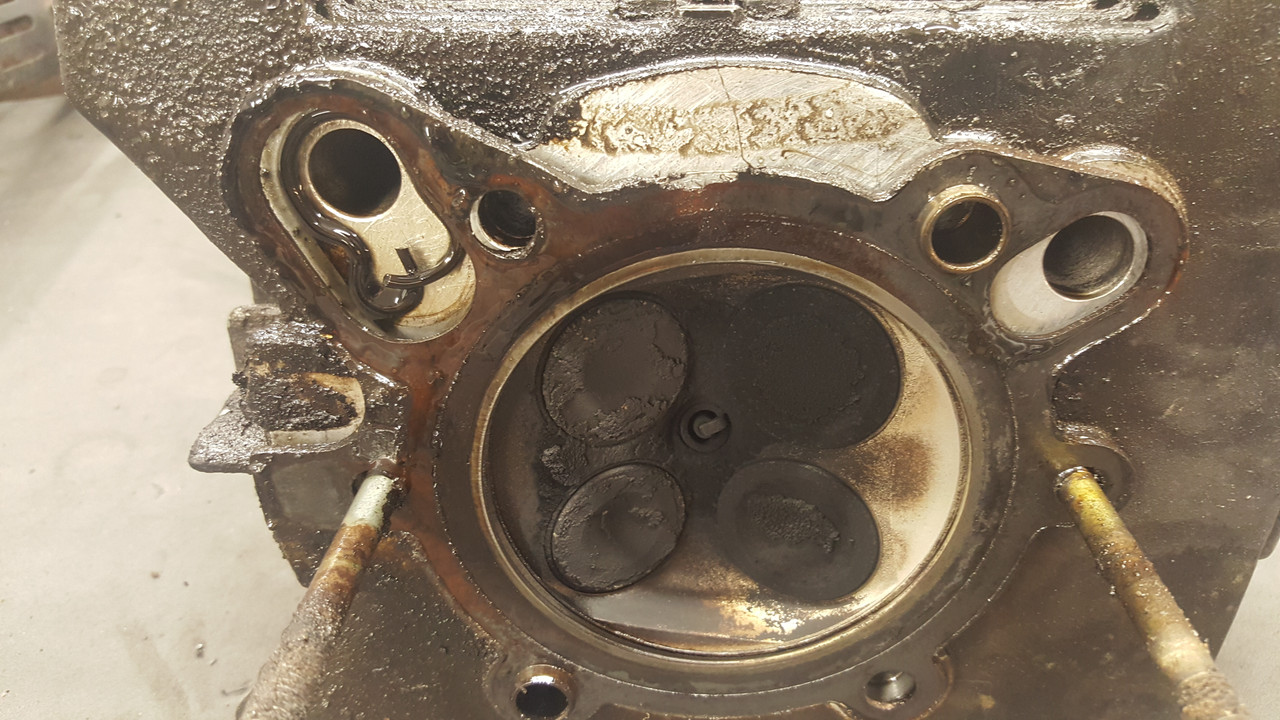

The picture above shows why the head gasket was leaking! MOD sub contracted engine rebuilds are some of the worst I've seen! With bits missing like this O ring brace. No gaskets for clutch and ignition covers, single lipped nitrile oil seals. Maybe thats why it leaked a bit of oil!
The road test was that much fun I went around twice!

Yesterday was all about ordering a few bits and pieces, Rob collected his refreshed Armstrong and checking out an MT500 engine which the owner said had no compression..
Here's what I found inside...
It gets even better..
No con rod no piston! That'll be why it's down on compression then!
Some bargains are not what they are cracked up to be! Not a lot we can do with this one as crank cases are damaged and oil pump is smashed..

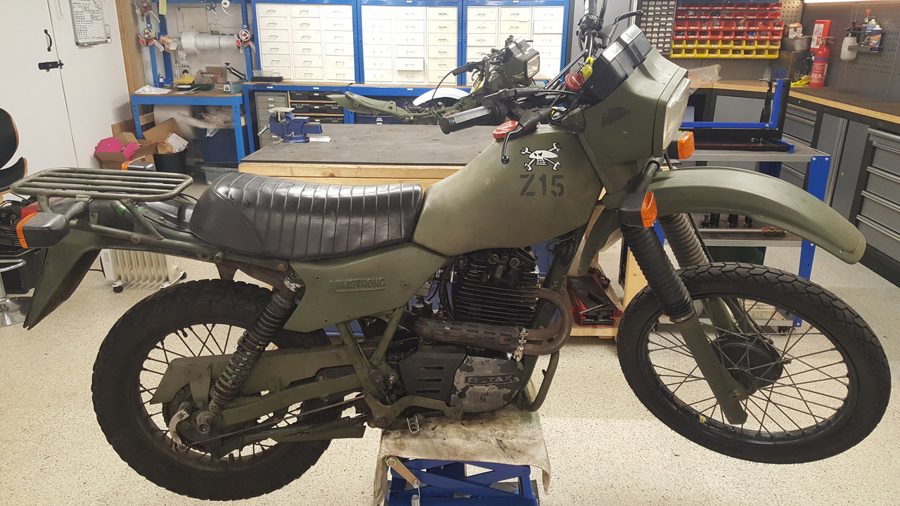

Today has been mainly about another Armstrong MT500. This one is a nice white example in for some Electric TLC.. New 3Ph Reg Rec, battery and a new rear tyre. Clutch also needed adjusting. All ready for an MOT and 12 months more fun for the owner!
