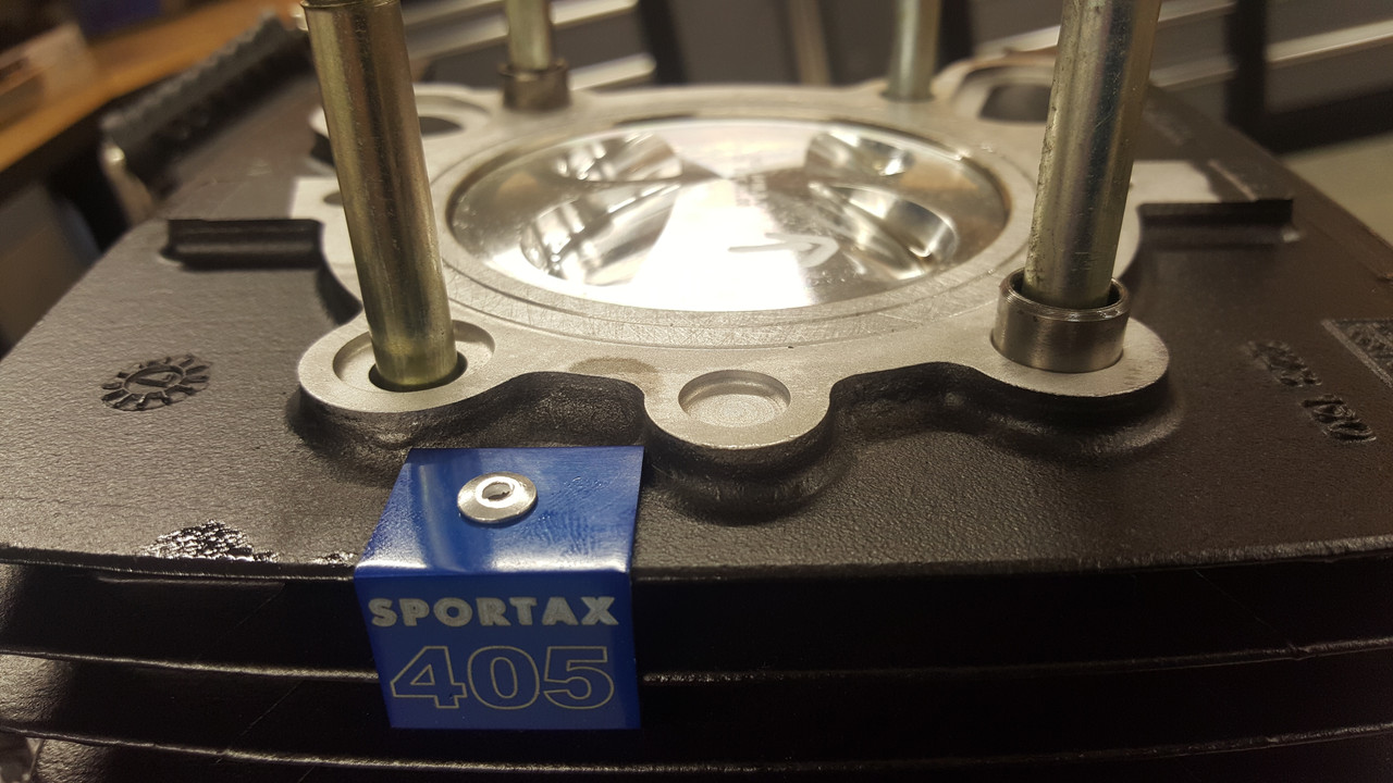

ian wrote:
Fri Feb 28, 2020 8:25 am
Hi Gary, what does the 405cc conversion yeald in terms of bhp and torque on a standard mt350 and is the head/ valve size the next most restrictive part, kind regards,Ian.
Hi Ian, a 405 kit with carb and silencer takes you from 18 rear wheel horse power to 37 rear wheel horse power.. we have got bigger valves for the 348 head but have not explored that route yet..

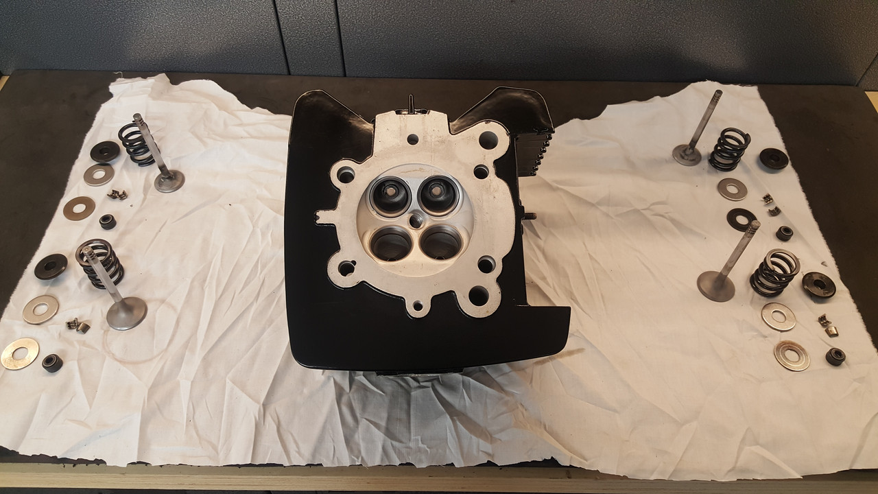

Yesterdays Tidy Friday had a different start thanks to the fly tippers down our lane.. Wish I'd have caught them in the act.
On a happier note the workshop is squeaky clean ready for finishing off next week an Aprilia 405 6 speed on the left. A 504mil in the centre and a 348 to 405 conversion on the right..

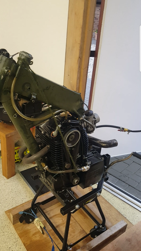

Post by Minter » Mon Mar 30, 2020 6:26 pm
Today was all about finishing the 504mil engine and firing it up on the test bed..
#skippy1970
Posts: 357
Joined: Sun Jun 21, 2015 2:32 pm
Location: Plymouth
Post by #skippy1970 » Mon Mar 30, 2020 6:54 pm
The engine test bed with wheels looks fantastic
Also Chocked into position :D

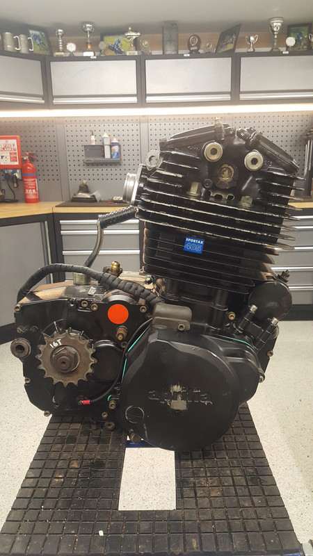

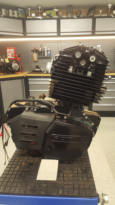

Post by Minter » Wed Apr 01, 2020 8:58 pm
Today has been mainly about a 6 speed 405cc Aprilia engine. All ready to be fired up on the test bed tomorrow..
