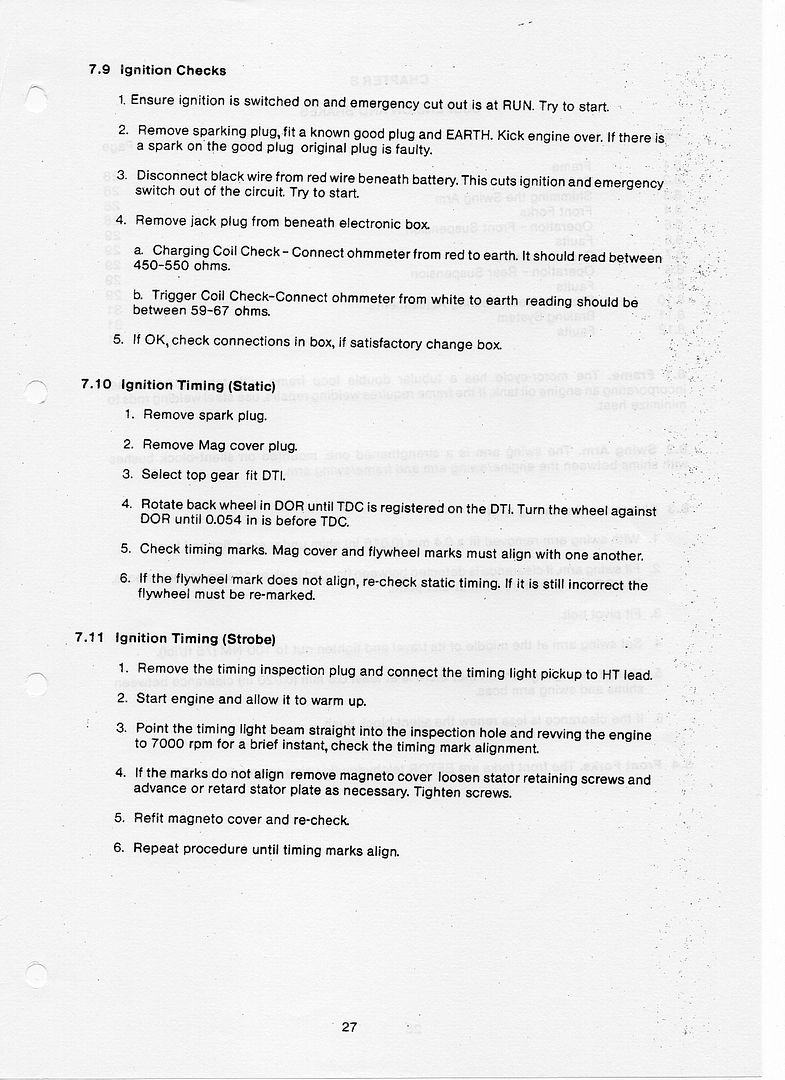

How do u check the timing on a canam 250

Bernie - sounds to me like you haven't got all the necessary manuals for the CanAm. Will try to scan and attach one of the relevant pages to answer this question. You need to get one of the CD's from my brother at Military CanAm with all the tech literature on.
Hope this helps you along the way.

Many thanks
