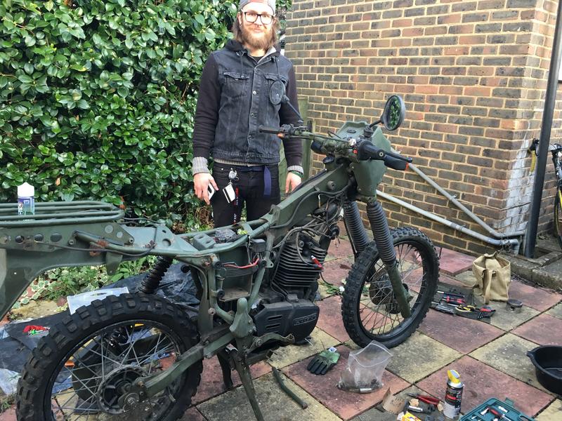

Felix has been after an mt for ages now and last weekend we actually found one within budget, so welcome to the club, I'll apologise now for a future of breaking down and camping in the rain..
First things first, strip the bike and squeeze it into my car :shock: I don't think we could have fitted any more bike into the back, bloody surprised the boot shut!
The bike's not on a bad state, but hasn't been run in a while as Ady was using her a welding jig. It's more of a let's find the bits we don't have and try to make it look presentable rebuild..
Today we connected up all the ignition and she actually sparked, I told him to look happy but this was all I got..
We've flushed the oil tank and engine out, but weirdly found a load of clear liquid that wasn't water (sunk to the bottom of a bucket of oil..) Any idea as to what it could be? Ady said the bike came from a museum. Is there a fluid you'd put in for storage reasons?
Hoping to rig up a carb and get her fired up soon

Good luck with your restoration and registration
You can get preservative oil. It is designed to coat engines to prevent rust but is not a lubricant for a running engine. If an engine is in deep reservation this type of oil can be used. I'm pretty sure you can get similar wax- like stuff for external paintwork ( just look at new cars being delivered ex factory on transporters or being carried on board ship).
You will never clean inside the frame, it might be worthwhile initially using some cheap oil and run the engine, then draining it and filling up with decent quality oil. I'd be tempted to change that before a normal service interval
If you need parts / service items, post in the Wanted section. You never know what is available until you ask
