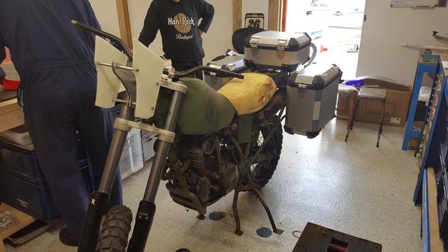

I was inspired by Deadgrass's flat face a few years ago and decided to have a go at something myself. The idea was to have it ready for Bonnielad and Co's trans Pyrenees trip a couple of years ago but I never got it finished in time!
My Dad was after another project to do so once settled into the new Sportax workshop the project began!
Here's a few pics of progress so far!

Forgive me if this has been asked/answered before, I couldn't find it int he thread--what front end is that? Does it bolt straight in to the Armstrong frame or are special bearings required?
They are CCM WP forks.. I had to turn down the shaft to get the MT bearings to fit and make a bush for the top bearing and alter the steering lock inside the head stock..
