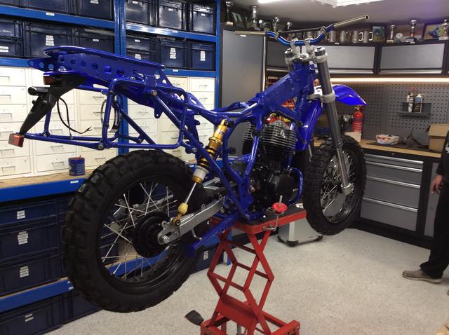

Posts: 4640
Re: ultimate mt
Post by Minter » Sat Jan 26, 2019 8:54 am
Progress on my ultimate MT is coming on!!
