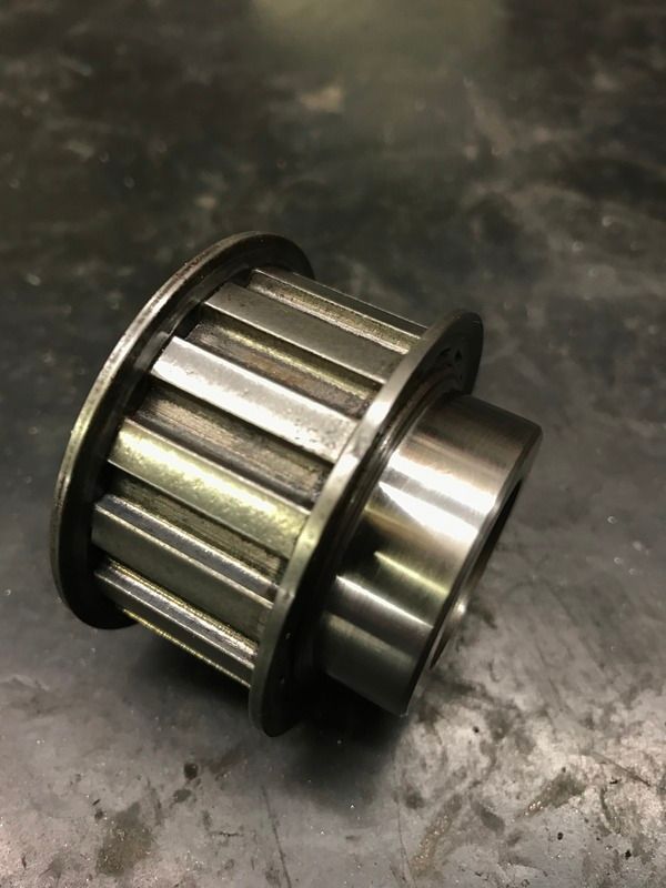

Post by Mr Shiney » Wed Feb 15, 2017 5:03 pm
Overhauled another bottom pulley. Reground and hardened to take a 34x47x7 seal as opposed to the original 35x47x7. I have done a few now and they are all still running well.

It looks good. I have no need for one ATM however if I need one in the future are you doing these on an exchange basis?

Post by Mr Shiney » Thu Feb 16, 2017 6:11 pm
appyarry wrote:It looks good. I have no need for one ATM however if I need one in the future are you doing these on an exchange basis?
Keep up the good work :-)
Yes I will as long as the damaged one can be taken back to tolerance.

Post by Mr Shiney » Thu Feb 16, 2017 6:25 pm
P.I.STAKER wrote:good job steve
did you need anymore seals?
Yes I will do in due course! I will supply each re ground fully with the correct size replacement I think.

Post by mt bandit » Thu Feb 16, 2017 6:54 pm
i'm getting these done by my local engineering co, at a tenner a go , the seals i get from lancashire seals at about nine quid as it's an odd size

Post by Mr Shiney » Thu Feb 16, 2017 6:59 pm
mt bandit wrote:i'm getting these done by my local engineering co, at a tenner a go , the seals i get from lancashire seals at about nine quid as it's an odd size
It's a standard seal and less than a fiver.

Post by mt bandit » Thu Feb 16, 2017 7:11 pm
well still happy with my viton seal and recon pulley for under £20

Post by Mr Shiney » Thu Feb 16, 2017 7:41 pm
mt bandit wrote:well still happy with my viton seal and recon pulley for under £20
To be fair it's about what I would expect it to be worth as a job. It takes me about 30min to clock it in (has to rotate round correctly) then grind.
