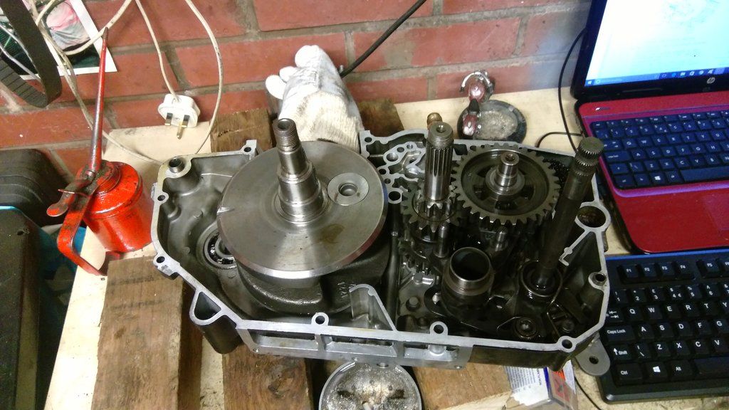

After finding someone to press my crank together, I have finally got round to putting it back in the casing. After putting the crank in the freezer and the casing in the oven @ 80 degrees for about 50 minuets, it just dropped straight in.

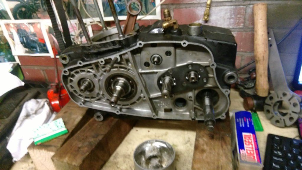

started to put the engine back together
Loads of other stuff to do at the moment, but hope to have the bike running by next year. I am sure that rustybike will be round at some point, with some more of his much valued help and tools.
