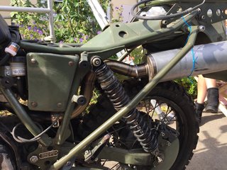

Amongst other jobs, I got round to fitting the exhaust today. Thanks to MadStu for selling us the link pipe, it fits like a glove and works great with the ccm silencer. Shame the cable ties won’t last long, I need to dig out a bracket from the shed..

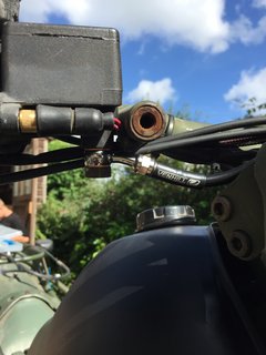

No way in hell would that 90 degree fitting ever work with an original master cylinder. Fortunately, I’ve got a stock of other angles.
Venhill are a waste of time matey, they use a different system of measurement to everyone else as well. I've had wrong hose from them for RD, fireblade, XS so I haven't used them for years. I thought I'd give them another chance when I needed a hose for the Transalp, guess what? It was wrong, utterly useless.
