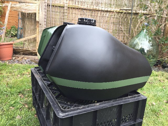

Post by Laurence » Thu Apr 02, 2020 8:17 pm
Work has kind of started again on this bike, Felix was after something a bit different with the tank, this is what we settled on after a few pub discussions

Post by snap1 » Tue Apr 07, 2020 3:46 pm
The tank design looks good!

Post by Laurence » Tue Apr 07, 2020 9:29 pm
Cheers, it’s always hit and miss wether a non standard paint job will look alright!
